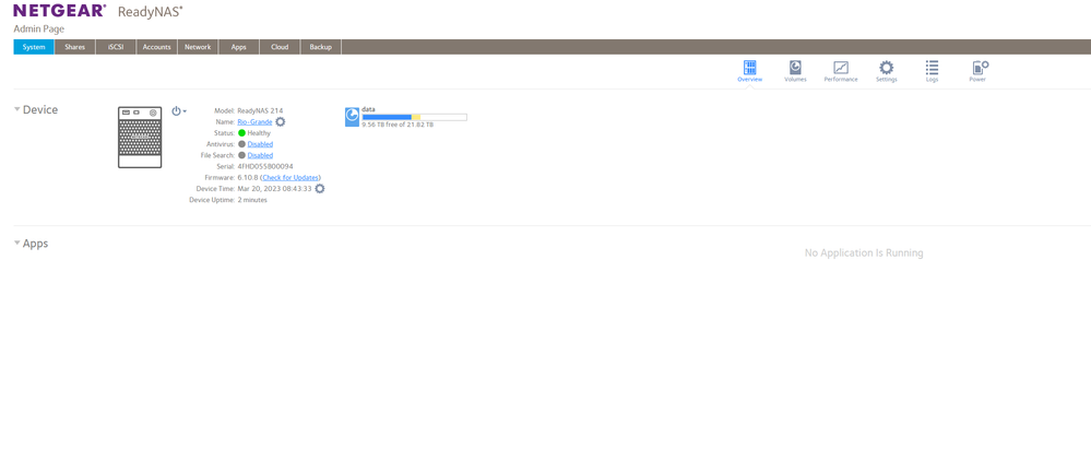

I have 2 RN214 units in my office.  One works faultlessly and the other did but now crashes a short while after booting.  Both are 214s running 6.10.8 firmware. Neither system is more than 65% full. The problem seems to be with the discs themselves as I can physically swap the arrays between my two boxes and the problem moves with the discs. The suspect system has 4 x 8tb WD Red WD80EFAX drives installed. All were new when installed.
The suspect array now only minimal system things running. Although previously it would have been syncing a one drive, running the antivirus, running scheduled defrags, but all of this is switched off now.

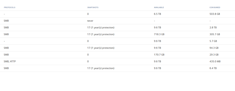

The only 'thing' I can see on clicking around the admin page in the few minutes I get is the snapshots/calculating data seems to be working hard. When I try to delete an older snapshots it never has time to complete the opertation.
Once the sytem has crashed I can no longer use the web admin page. However, I can still ping the unit. This is true for both network connections.
All the data appears to be intact on the system as I can play camera rushes (videos) for a while when the system has booted. I can also see all folders/shares working as they should for a short while.

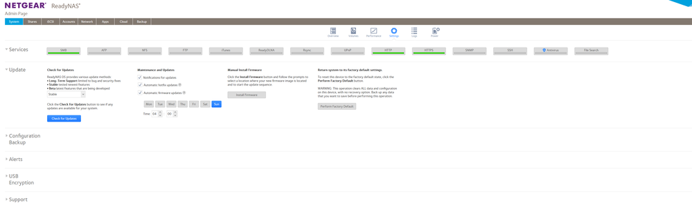

shutting down all extra services (only SMB is running now)

      I gave the unit half an hour and then rebooted in normal mode. Same problem, as expected. However I tried to start disabling the snapshots but the unit crashed before any of the changes could be applied. Naturally I can't make changes in read-only mode so how would you suggest I proceed from here, please?
