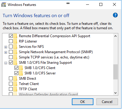

OS 4.2 systems only support SMB 1.0 - which Microsoft is deprecating. So one thing to check is whether the SMB 1.0 client is enabled in your Windows 10 systems. If not, the simplest fix is to turn it on. If you enter "Turn Windows Features on or off" in the windows search bar, you should see the settings come up. Click on that, and look for SMB 1.0/CIFS. The screenshot below shows both the client and the server enabled, but you only need the client to access the NAS.
Enabling SMB 1.0 does require you to accept it's security risks. There is a experimental support for SMB 2.0 in OS 4.2, but it requires SSH access to enable it. I think the better approach would be to convert your ultra to OS-6, which supports SMB 3.0. Netgear doesn't support running OS 6 on your NAS, but many people here have done it.

Thankyou for extended response, just to clarify is there a plain setting in Windows 10 to re enable SMB 1.0.

I posted the screen shot of that "plain setting". If the box next to the SMB 1.0 client is checked, it is enabled.
