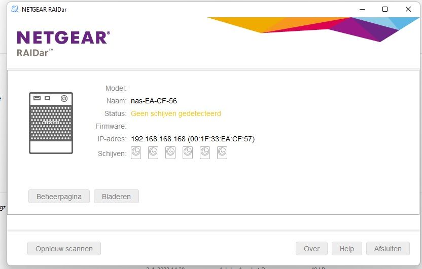

- SandsharkJan 12, 2023Sensei
If you see nothing (including not even a blip on the Ethernet LED) with no drives, then it seems you probably have a bad Ethernet transceiver or hardware supporting it, which is not repairable. Given you are still running OS4.2.31, your options for replacement are more limited. Another Ultra6, and Ultra6Plus, or a Pro6. If the replacement has been converted to OS6, you can convert it back, but have to do that using a spare drive before you install your drives.

It is booting I think. I get the message ERR: No disks detected. And I see the NAS with RAIDar but with a different IP: 192.168.168.168 so I can not reach it. And there is network activity. What to do now?
