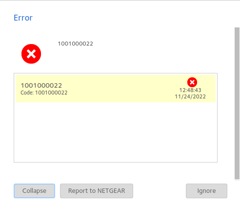

I also got a weird error message on the screen, which do not appear in the logging- StephenBGuru - Experienced User
I think the error code is related to email alerts. Are you using gmail for that? If so, have you switched to using an app-specific password?
