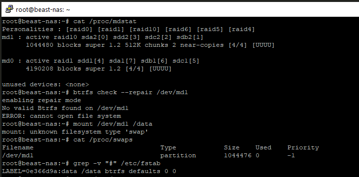

I can't access any of the 4 hard drives in my ReadyNAS 104.  As a result all network shares are inaccessible.  I'm running firmware v6.10.4 and the admin web interface is accessible however it states "Remove inactive volumes to use the disk. Disk #1,2,3,4."
Things were working fine until the drive booted today.  I've not recieved any prior warning about any issues with the drives however after looking through the forum and reading some articles I think the amount of free space remaining may have played a part: - there are 4 x 3TB Western Digital drives in the NAS and as you can see from the above screenshot there's 10.90TB of data used, so it's over 80% consumption.
I began following this post which talks about running `btrfs check --repair`, mounting the drives and deleting some data to take it below the 80% however as you can see from the screenshot below I've not had much luck.

    there are 4 x 4TB Western Digital drives in the NAS and as you can see from the above screenshot there's 10.90TB of data used, so it's over 80% consumption.
    The information in your screenshot tells you nothing about free space.
    1. The free space indication is meaningless when the volume is not mounted.
    2. The 10.9 TiB indication is the total volume size, not the amount of space used.  The NAS reports space in TiB (1024*1024*1024*1024 bytes) - even though it uses a TB label.  10.9 TiB is the same as 12 TB - which is the size of a 4x4TB RAID-5 volume.
    BMuuN wrote:
    You are trying to repair the wrong volume.  md0 is the OS partition, and md1 is the swap partition. Neither uses btrfs.  Your data volume should be md127, so maybe try that.
    But you are risking making things worse.  Another option is to use Netgear paid support, which would greatly reduce the chance of data loss.
      When I run `ls -la /dev` I don't see `md127`. Is this because the drive is not mounted?
      By the sounds of it running `btrfs check --repair /dev/md127` will do more harm than good?  Is my only option here Netgear support?
        Likely yes.  You might need to do a btrfs device scan before you try the repair.

    What NAS do you have?  If it's an ARM model, md0 is not BTRFS.  But that's not the problem, anyway.  md0 is the OS partition.  Your /data partition is most likely md127, which isn't mounted properly and is, thus, your problem.
    One thing you failed to note in the post you referenced is that the user is doing that in another Linux system, not the NAS, and he has just RAID1, so can do that with only one drive.
    You can try the --repair option, but I don't think it's going to work without at least unmounting /data and /data-0.  Normally, I believe it has to be done via the support mode so it's already unmounted and you and the OS are not fighting over it.
      His screenshot (mdstat) shows they aren't actually mounted.
      I have a ReadyNAS 104 with ARM processor.  As mentioned above I don't see `md127` in `/dev`.  Could this be the reason for the issues and do you have any tips on trying to remount this partition?
