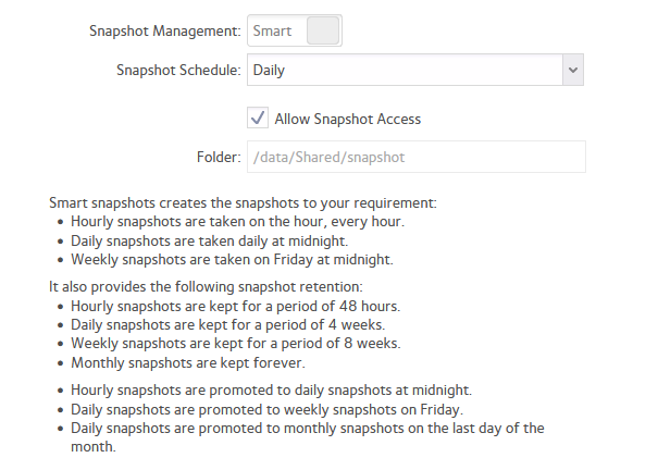

I found this post from 2021, but I am not seeing what I expect from snapshots.
I have had this config for a long time, let's assume >2Y. I expected a monthly snapshot to be retained, as the daily>weekly>monthly promoted snapshots are cleared out - specifically the last bullet point above.

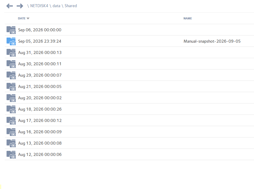

However, what I see is snapshots back to the start of Aug'26:
I am a bit confused that promoted monthly snapshots are not being retained; I have 5.75TB / 14.54TB free, and my NAS is powered on 24/7 - although I do have disk spindown enabled.
Am I misunderstanding the way promoted snapshots work?

    • StephenB's avatar
      StephenB
      aks-2 wrote:
      but right now I'm thinking smart snapshot manageent is too random to be reliable.
      FWIW, my custom settings are working as intended.
  • It's acting as if it's doing pruning -- like it believed you were running out of space.  Are there any warnings in the log about running out of space?  Note that with BTRFS, you need to worry about both data and metadata use.  Perhaps you are running low metadata.  From SSH, what do btrfs filesystem df /data  and btrfs filesystem usage /data show (assuming your volume is named data)?
    Are you doing periodic defrags, and did one occur just prior to the mass deletions?  Defrag and long-term snapshot retention don't go together well.  Snapshots not taking much real space relies on the fact that most of the data doesn't change, and the snapshot simply points to most of the same sectors as the active data, not all different ones.  Defrag moves the active sectors around, but cannot tell the snapshots where they moved to, so the snapshots still point to (and thus retain as in use) the old locations while the active data marks other sectors as in use.
    Backups of some types of files that are large but don't have a lot of changes can also cause a lot of unnecessary content duplication.  Large drive images and encryption volumes are examples.
    • aks-2's avatar
      aks-2
      Apprentice
      Yes, something triggered the mass deletion, it seems quite random, I can't see anything in the lofs that would indicate a reason (so I am quite baffled 😕).
      I don't believe there is any issue with free storage space, I generally do not delete anything on the NAS (it's mainly photos, family video, music, etc). Here is the live info

      • aks-2's avatar
        aks-2
        Apprentice
        Looking at status.log again, I observe the snapshot deletions (clearouts) seem to happen soon after a reboot:
        I haven't yet run my script to check the ages, but here is a snip:

  • Guys, deleting older snapshots behaviour seems consistent now, nothing lasts more than ~4-5 weeks.
    However, Sandshark​ mentioned defrag and snapshot don't play nicely, and I did a defrag 21-Aug - maybe this caused this round of deletions (a bit delayed however, and not all (yet)):
    This is a processed log from today (status_2026-09-17.log):

    2026-08-29 00:00:09    C168                                        8   oldest: 17     [161, 162, 163, 164, 165, 166, 167, 168]
    2026-08-30 00:00:12    C169                                        9   oldest: 18     [161, 162, 163, 164, 165, 166, 167, 168, 169]
    2026-08-31 00:00:14    C170                                       10   oldest: 19     [161, 162, 163, 164, 165, 166, 167, 168, 169, 170]
    2026-09-05 23:39:25    C170                                       10   oldest: 24     [161, 162, 163, 164, 165, 166, 167, 168, 169, 170, 170]
    2026-09-06 00:00:01    C171                                       11   oldest: 24     [161, 162, 163, 164, 165, 166, 167, 168, 169, 170, 170, 171]
    2026-09-08 07:57:51    C171                                       11   oldest: 27     [161, 162, 163, 164, 165, 166, 167, 168, 169, 170, 170, 171, 171]
    2026-09-11 21:05:19          D162  2026-08-13 00:00:09  age: 29   10   oldest: 30     [161, 163, 164, 165, 166, 167, 168, 169, 170, 170, 171, 171]
    2026-09-11 21:05:19          D161  2026-08-12 00:00:08  age: 30    9   oldest: 26     [163, 164, 165, 166, 167, 168, 169, 170, 170, 171, 171]
    2026-09-13 10:05:28          D163  2026-08-16 00:00:10  age: 28    8   oldest: 27     [164, 165, 166, 167, 168, 169, 170, 170, 171, 171]
    2026-09-14 14:05:45          D164  2026-08-17 00:00:14  age: 28    7   oldest: 27     [165, 166, 167, 168, 169, 170, 170, 171, 171]
    2026-09-15 09:06:10          D165  2026-08-18 00:00:28  age: 28    6   oldest: 26     [166, 167, 168, 169, 170, 170, 171, 171]
      defrags can greatly increase the snapshot space (as Sandshark​ pointed out in his reply).  The puzzle here is that the defrag completed quite quickly.
      In any event, the auto-deletion for volume safety deletes the oldest snapshots first, and stops when the free space goes back under the threshold.  So it is possible I guess.
      I didn't notice that the defrag and the balance were run back-to-back.  So maybe also run another balance, now that you know you have free space.
