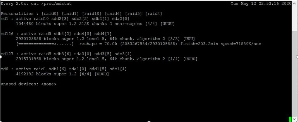

Also, thanks for the SSH command line to watch the reshaping. Still on 3rd disk, has been 24 hours so far with roughly 3 hours to go. I suppose the 4th disk tomorrow is going to take 36 hours if I extrapolate. Wow. This odyssey will end up taking 4 full days to complete, with only a few hours of "idle" time due to this third swap finishing in the middle of the night.
