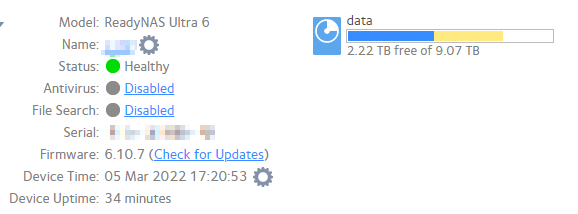

My NAS overview page:

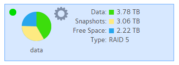

Volume summary info:

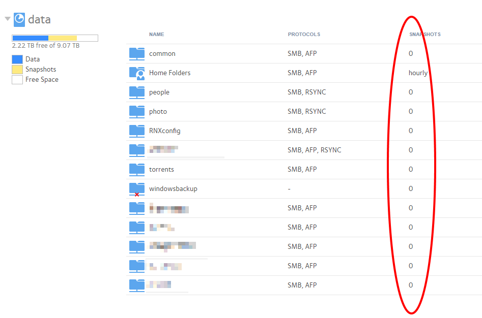

List of shared resources (please notice there are no snapshots):

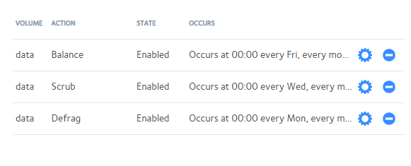

Configured maintenance:
