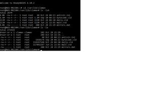

3. File search
a. Search for any large files >200MB: find /var -type f -size +200M
b. Look into Antivitus definition directory for any temp files: cd /var/lib/clamav
ls -lsh
c. Look into media/USB_HDD_1 (that is my 8TB USB connected HD) folders for any files
Result 3a-c: no large files, no temps, nothing peculiar in USB_...
Some threads can be found here where users had to delete the /clamav tmp files, not in this case.

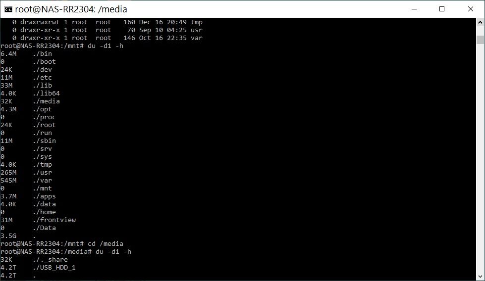

4. Mount the root partition as mnt to eliminate directories from listing that actually point to the data partition
a. mount --bind / /mnt
b. ls -lsh -> found many chunk-0000x files in the root directory (StephenB telling that this is from PLEX transcoding)
c. Delete files: rm /chunk-00*
Another ls -lsh: all chunk deleted and reduced partition usage from 3,5G to 1G

I did the mounting btw. as mnt, it shows me 3,5G, which is 87% of 4.
Changed into media trying to catch something "underneath" but.... unsure
