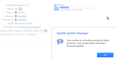

bengsig wrote:
However, clicking update, I am told I am on the latest so I cannot upgrade to 6.10:
First of all, you are seeing that message only because you've chosen to set "Check for Updates" to "long term stable" on the system->settings->update page. You can just change that setting to "stable" and you will get 6.10.10
However, if you have apps installed, then I suggest stopping at 6.10.9. 6.10.10 removes the ability to install apps from the web admin apps page.
You can download 6.10.9 from here:
Extract the firmware from the arm zip file, and then install it manually (system->settings, then press the "install firmware" button in the middle of the page.

Thanks a lot for pointing me at that script. However, https://gitea.threefifteen.info/readynas-scripts/share_lun_ui_fix.sh/src/branch/master/README.md tells me I need to be on ReadyNAS OS 6.10.0 or newer, and my ReadyNAS 212 is on 6.9.6. However, clicking update, I am told I am on the latest so I cannot upgrade to 6.10:
Any other suggestions?
