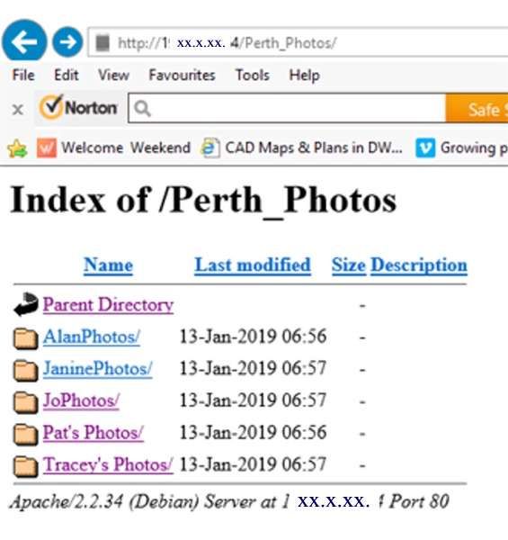

I have created a share on my NAS (Perth_Photos) and I think I have done everything correctly, yet when I go to my browser and type in http://1XX.XXX.X.XX/Perth_Photos the browser displays this.
Where am I going wrong, any ideas?
I thought that I would be seeing a folder similar to that shown in my Admin Page whereby I could just drop photo's.
Thank you in advance.
  • BigAl1 wrote:
    Obviously I can get into the Share via my admin login, but the idea behind all this is that I have just spent 4 weeks in Perth W.A. with my 3 daughters, 2 of which live in Australia, the other lives here in the UK.
    Well, if http is enabled for the share (not just enabled in system->settings) then  http://1XX.XXX.X.XX/Perth_Photos should show it.
    Looking again at your screenshot, it appears to be doing that (at least showing folders in the share), so I am unclear on what your problem actually is.  If you click on the subfolder links you should see the photos in them. However, you really want remote access to the NAS over the internet, which isn't the same as just enabling http.  You'd also need to forward ports in your browser and set up DDNS. And http isn't a secure way to access the NAS remotely, so I recommend using a different approach.
