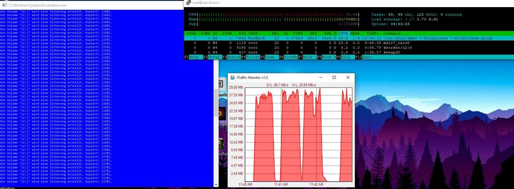

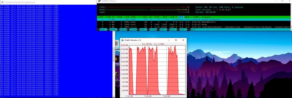

smbd / btrfs-Transaction high load on cpu - Bug while Backup Job WIndows 10
smbd_High_Upload_Activebtrfs-transaction_High_Upload_InactiveHey guys, while WIndows wbadmin Backup i get the following problems, which leads to
- NO ACCESS to my File System while btrfs-transaction is on high load (Browser stuck / Explorer Stuck)
In the pictures is clearly visble that the process leads to a stop in uploading the Backup, which is not acceptable while doing a whole WIndows BackupImage to the Network.
FIX this please!

        Problem startet in February 2018 (Where my last Update was made- but it should be daily)
        I recognized  the process failed after watching for something else in the windows report, and because of the old backup files.
        Readynas
        - FW: 6.9.3
        - dust freed
        Data Volume:
        - 4 x 1 TB WD Red something which is to use with this NAS . i checked tripple
        - XRAID
        - data 1,39 TB
        - Snapshots: 516.28 GB
        - Free Space: 838.51 GB
        - Total ~ 2,73 TB
        - Type: Raid 5
        -TRIED STUFF-
        * switch off Bit-Rot from every share
        * defrag
        * delete snapshots
        * switch samba protocols (smb 2 /3 ) ((installed samba plus for that)
        * scrubing
        * new users
        * iperf (works great)
        * write I/O internal 54 MB/s
        * write from Network 29 MB/s
        * read  from Network 55MB/s
        -> wbadmin backup stream ~ 240 GB
        Trying at the moment:
        * balancing
        process which takes 100% load "brtfs-transacti "
        why a transaction on the file system stopps the whole samba process by sucking away the power ?
        -> Priority?
        Hope I could feed you with Infos.
        PC:
        Intel i5 somewhat
        Network works great to other devices
        The SambaProcess slows and fastens by occupied and free cpu % power
        Can someone stabilize this **bleep** ?
        -> Controlling Application Consumption
        Sorry I am an intermediate linux user / advanced windows user - but when you use a Marvel ARM Board with 1,2 GHz then optimize it. Every process going wild at that thing.
