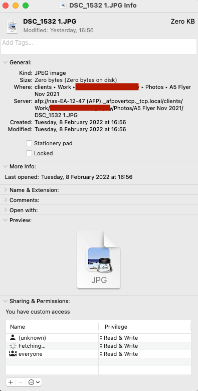

I also noted that when I check the file info on a zero bytes file, there is an issue with one of the users (this spinning circle appears on teh file info on all files)
I have given my colleague a separate user account with full privelidges as he uses it the most and was concerned it was a corrupt account. But this did not change anything.
