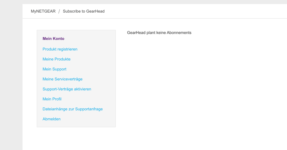

  • My SXR80 worked great with VLAN until last FW Update, now I have a lot of new problem and the 90 days are over for support. :-(
    What do I do now? Trash it and get a new one? I tried to buy support, but there is no support....
