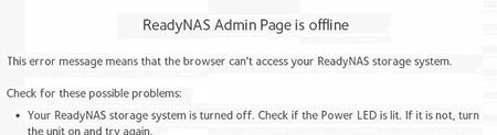

Hi, For some days, I can no access at my configuration web page. I have the web page : We are running firmware 6.4.1 My ReadyNAS is used as like a files server. I always have access to my shares. But after a while time, my users lose their access and I have to restart my READYNAS. I also noticed that my root space was full. I didn't find any folder too big. I looked for every folder without find. I didn't know why the 'root' was at 100% and why configuration web page doesn't work. Could you please help me ?5.6KViews0likes16CommentsBooting... Found bad disk -> comment contacter le support
