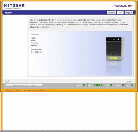

Had my second power supply fail last week. Found another in the UK, installed, and was greeted with this screen... I first tried OS re-install, but no change. I'm followed that with factory reset, and while it's still syncing, I'm getting the same screen in Frontview (cache cleared then reloaded). Will I need to wait for the sync to finish, or is there something else wrong? The NAS currently houses 4x2TB drives, and the data is backed up - hence the reset. Raidar setup after reset was normal. Prior to the resets, data was accessible and appeared normal. Thanks for your time. edit: Frontview might have been corrupt prior to the power supply failure. I hadn't pulled it up in months.Solved5.1KViews0likes15CommentsReplacement disk not recognised Readynas nv+ RND4000
