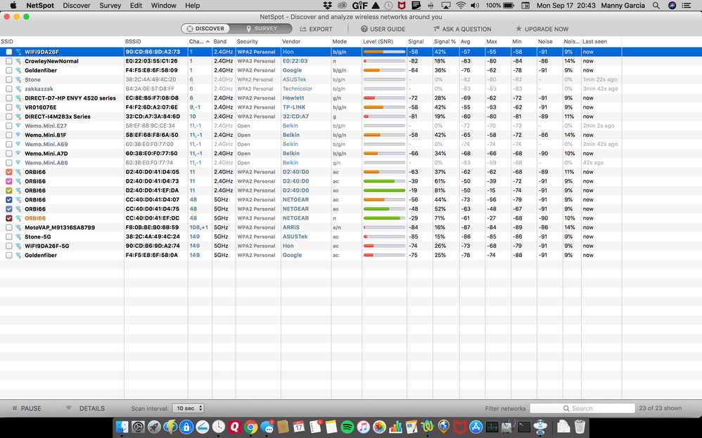

      • Neighbors near by:  yes - see NetSpot screenshot attachment

        Forgot to upload the netspot screenshot. here it is. Also, I have Beam Forming on (per NG tech support)
