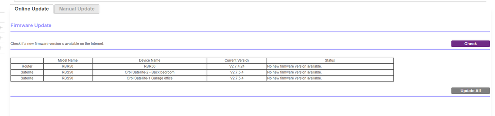

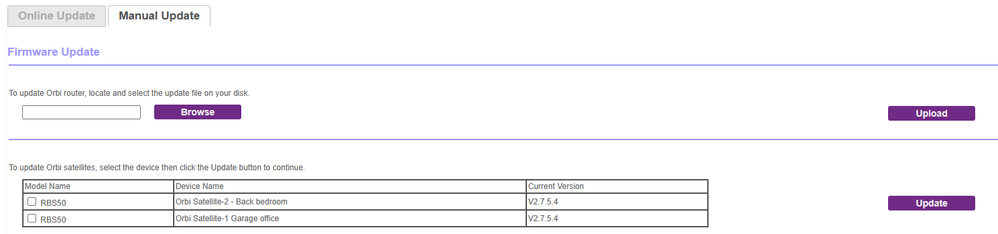

Hi my experience is as follows:
I have 1 x RBR50 and 2 x RBS50s all were on V2.7.4.24
I just updated my 2 x RBS50 satellites from the Orbilogin and used the manual option (downloaded the new v2.7.5.4 and extracted to a dedicated folder. This worked successfully and both satellites were showing green in the app however one has dropped to amber status but still working. However the RBR50 is not showing in the Orbilogin as needing a firmware update see screenshot below
When I go to manually update I see the RBS50s only which are up to date see screenshot below:
I am concerned as this update carries critical security fixes I would like to have the RBR50 aligned with the RBS50s, I believe its good practice to have them in synch for performance reasons. Please can anyone help me I am UK based.
Log into the RBS web page using the IP address given to them by the RBR. Use the RBS web page to update FW there.
Always be sure to update the RBS first, the the RBR lastly.

- SlychlanderAspirant
Hi I follow your instructions however they don't fix the issue if you read my first post the main issue is the RBR50 firmware cannot be updated, however the RBS have been successfully updated to v2.7.5.4, my question is why does Netgear have a firmware update shown on their website yet I am unable to update to it? As mentioned it leaves the Router and the satellites on different firmware versions which is not good practice. Take a look at the screenshots I have posted they explain the issue.
Thanks for your further consideration.
- dougwrightAspirant
Hello,
I was upgrading my RBR50/RBS50 from 2.7.4.24 to 2.7.5.4. As per the documentation I attempted to manually upgrade the satellite first. This seemed to go well, but after the satellite restarted it still reported its version as 2.7.4.24. I tried to upgrade it a second time, but on that attempt is said I was trying to upload the same firmware version. Moving on to the router, it upgraded to 2.7.5.4 fine.
Both the router and satellite appear to be working correctly, but I'm not sure what to do with the satellite now with it still reporting it's at 2.7.4.24 and saying I'm trying to upload the same version if I attempt to upload 2.7.5.4.
Any assistance would be appreciated.
Thanks
When the Orbi complains, "trying to upload the same version", I mutter, "well, duh, just shut up already and do what I tell you to do." Click, "Yes", Do it.
And be sure to use the RBS web page to send the FW file directly to the RBS, and not the RBRs web page.
