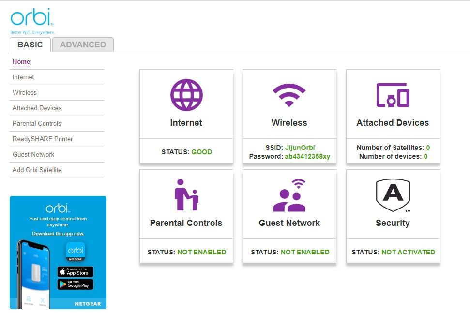

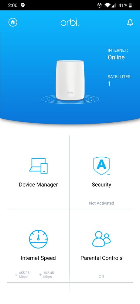

  • Dea, after I update firmware to v2.5.1.31, I have issue with Orbi Web view don't display any "Attached Devices", same as on mobile device. on mobile app still show connected RBS.

      Has a factory reset and setup from scratch been performed since last FW update?
      Press the back reset button for 15 seconds then release.
      Try a different browser, IE11, Edge, Firefix or Opera.
      Be sure to clear all browser caches before starting the setup wizard.
      IF this fails to correct the problem, please revert back to v16:
      https://community.netgear.com/t5/Orbi/RBR50-RBS50-Firmware-2-5-1-16-Update/m-p/1897955/highlight/true#M89460
