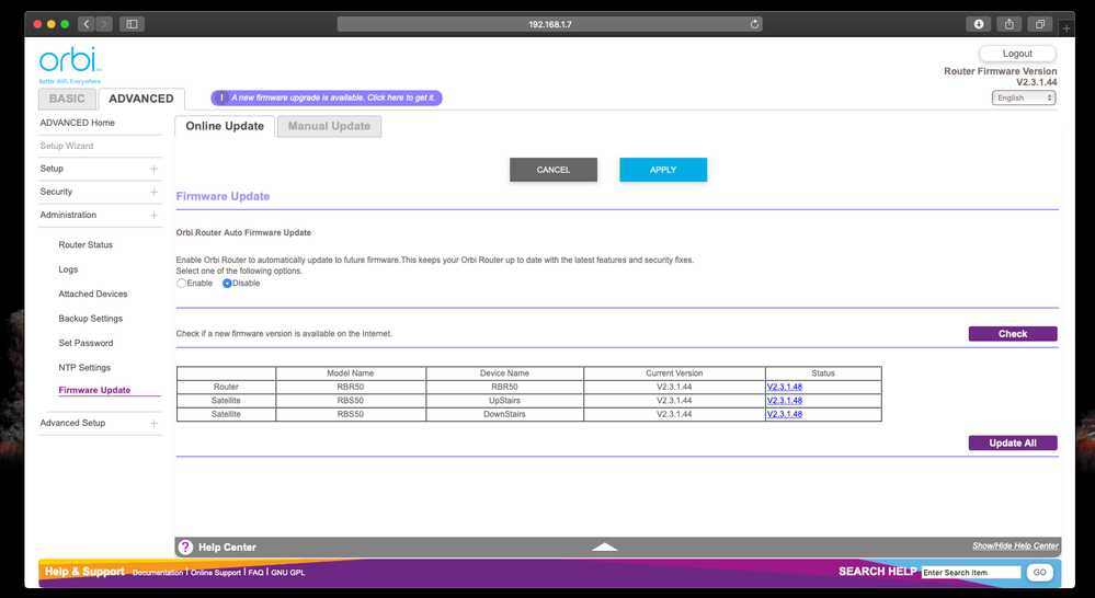

  • Hello,
    Can you kindly explain please how on earth you're ablie to get the switch to enable disable auto updates?
    SW_ wrote:
    • FURRYe38's avatar
      Is the disable radio button not working for you?
      gr8sho wrote:
      Hello,
      SW_ wrote:
      • gr8sho's avatar
        gr8sho
        Virtuoso
        I don't have it.  Was it introduced in .48?  This is a question I've asked before with no response.  I don't want to update unless I know for a fact it comes with the new firmware as I'll have to schedule a factory reset.
      • FURRYe38's avatar
        I see, gotta enable this hidden feature. I'll try this out. :smileywink:
        SW_ wrote:
        Re: New Orbi RBR50/RBS50 Firmware Version 2.3.1.48
        Hello,
        @SW_ wrote:
        Hi gr8sho ,
        Please check Orbi-Router Auto Firmware Update Switch.
        Have fun!

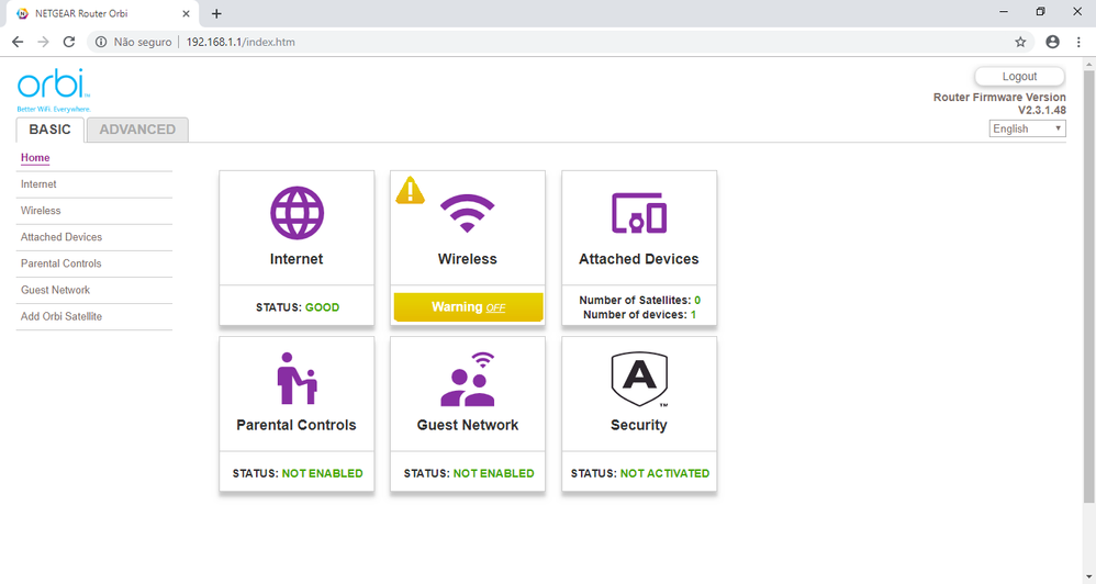

      I think something is missing here.   I see posts like this from time to time that have no visible images
      RCWielewski wrote:
      This is my BAD experience...
