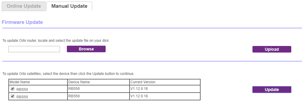

I setup the Orbi router and 2 satellites which came with firmware 1.12.0.18. Powered them up, pulled the cable from my router that went to my PC and connected my PC to the Orbi system (local LAN, no internet connection). I set it up, then tried to manually update the firmware on the satellites from the v2.1.1.16 zip files (unzipped, pointed to the disc image file for the update), but got a message that the file was incorrect.
I've just re-connected my PC to the 'net and got fresh copies of the 2.1.1.16 router and satellite firmware and will try to manually install it again after I post this message. Not exactly a glorius start here.

Rebooting my router always turned off the wifi some reason as well. What a cluster. I rolled back to v2.1.1.12 and did all the same troubleshooting. I had the same symptoms and problems (wifi is off after reboots, Wifi password in gui only shows first 3 letters, satellites won't auto sync after reboots.) Reluctantly knowing the security risks, I decided to roll back to v2.0.0.74 since some users reported some stability there. Here are the steps I used to get to a working state:
1. Rolled back my 2 satellites to v2.0.0.74. Note that Netgear KB articles state to always do firmware updates on the satellites first then the router. Also Netgear articles state to use wired ethernet when uploading and doing firmware updates.
2. Defaulted my Router using the GUI. Advanced>Administratorion>Backup>Revert to factory defaults. Ran through the basic setup and Admin password and setting up Wifi. I skipped setting up the satellites since I am rolling back firmware first.
3. Rolled back firmware on the Router to v2.0.0.74. Immediately I noticed that my Wifi password in the gui is not correctly showing the full password which I took as a positive sign. Additionally, wifi stayed on this time.
4. For good measure, I decided to default the router again (step 2) to run through the first time setup. Only this time I did go and sync the 2 satellites.
After this, I am back to a good working state. My Wifi is still on after rebooting my router, and the satellites now auto sync if they are turned off/on and no longer need to be within 20ft distance from the router. Phew...
