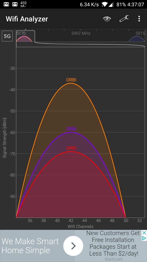

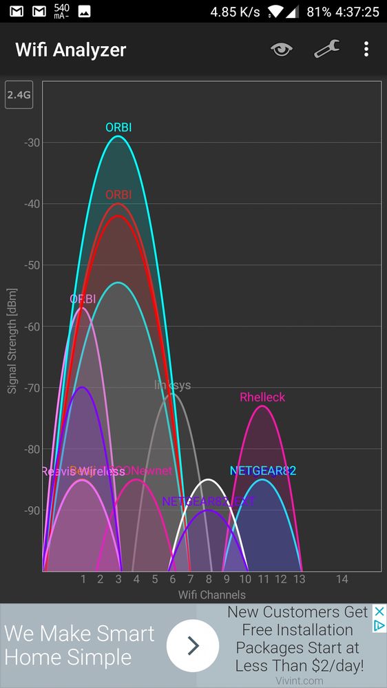

I just noticed something odd. I cranked up Wifi Analyzer and was checking my signal outdoors and happened to notice the channels. Take a look at my settings and then see what Wifi Analyzer shows. The channels I set are not being used. Or they don't appear to be. I'm sitting about 5 ft from the RBR50 when I took the Wifi Analyzer screen shots.
5 GHz radio should be on channel 482.4 GHz radio should be on channel 1Channel settings in the RBR50

Following up to the above post about the band discrepancy, I cranked up Inssider on a laptop and did not see band assignment issues. The assigned bands showed up properly. I cannot reconcile the difference between WiFi analyzer on my android and Inssider on a laptop.
Your Orbi is using a 40 MHz width on 2.4 GHz. You set it to Channel 1 and it uses 1 - 5, which extends just to the edge of channel 7.
Your Orbi is using an 80 MHz width on 5 GHz. No matter what channel you set in the GUI, Orbi will always use channels 36-48.
These channels are what's shown in the plot you posted, so everything is working properly, but the way Orbi uses channels is confusing compared to the choices in the GUI.
