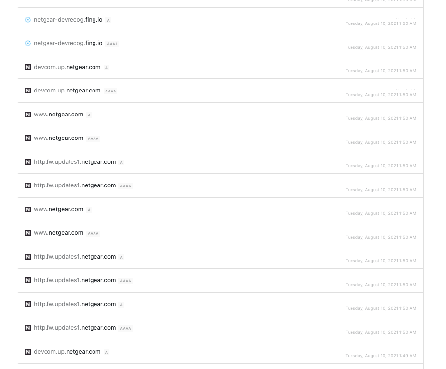

Today, I found my router forced update firmware to 2.7.3.22. Is it normal or not? because I use 2.5.1.16 is very stable with my environment
It update around 2am GMT+7
Is it normal for this behavior?
Netgear calling DNS records
  • I was able to complete this successfully, and downgraded to a stable version firmware.
    Here's what I did based on FURRYe38 suggestion, I set Orbi to AP mode first, then connected to a spare router that I have and blocked all ports for Orbi update service (updates.netgear.com or updates1.netgear.com). The auto upgrade finally stopped, everything is back to normal and I'm happy. Thanks everyone who offered to help!
