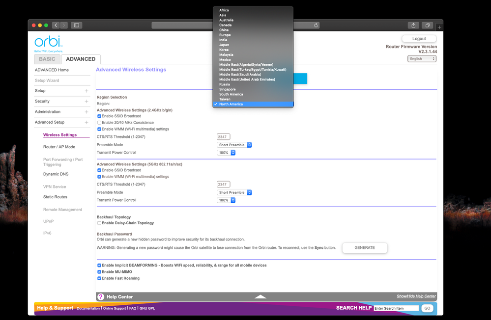

If you'd like to save some bucks and buy Orbi from Costco and bring it home outside the US, but you want to make a region change from North America to your region, try this:
1. Login to Orbi/debug.htm page and enable telnet (tick telnet box)
2. telnet into Orbi and type these:
  • root@RBR50:~# rm /tmp/firmware_region
  • root@RBR50:~# echo WW > /tmp/firmware_region
3. Check the result, it should return WW
  • root@RBR50:~# cat /tmp/firmware_region
Go back to Advance Wireless Settings page and refresh it.  You should be able to use Region Selection drop down menu to select your region.  Alternately, you can also use artmtd command, see ekhalil's trick.
Good luck!

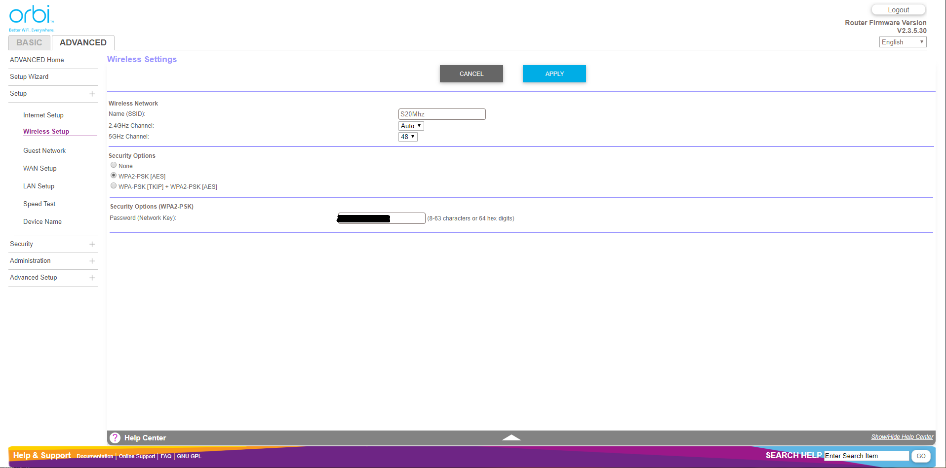

  • HI, this no longer seems to work. I tried with my router firmware is V2.3.5.30.
    I telnet succesfully and change the file but when I login it doesn't give the option to change region under advanced wireless.

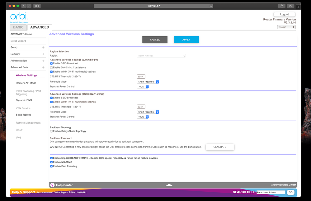

      • simzhewei's avatar
        simzhewei
        I enabled telnet and telnetted in,
        I used both:
        and check the result, it should return WW
        also
        artmtd -r region
        The region number is: 0x0002
        REGION: WW
        I logged back into the router and went to the advanced wireless and refreshed. This is what I see:
