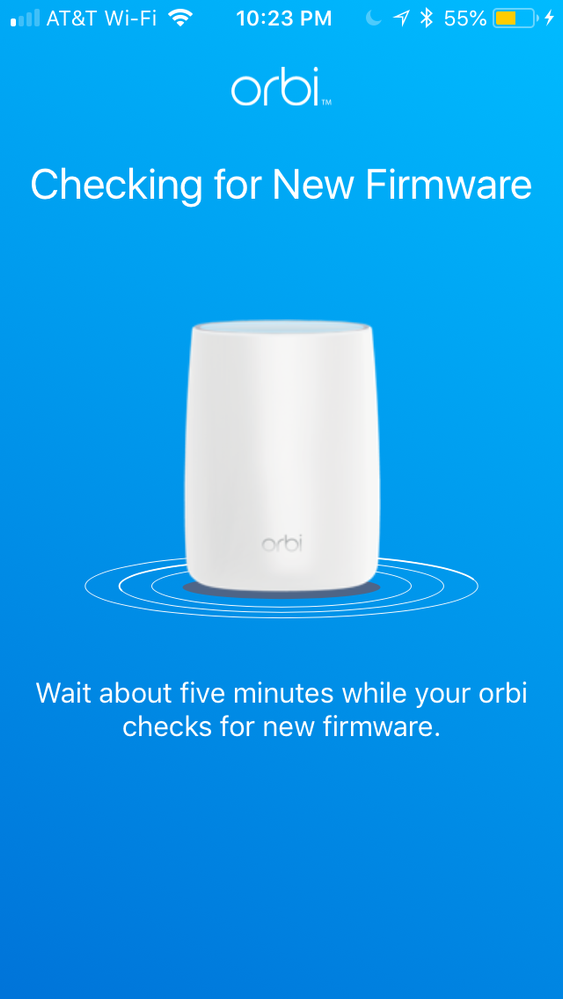

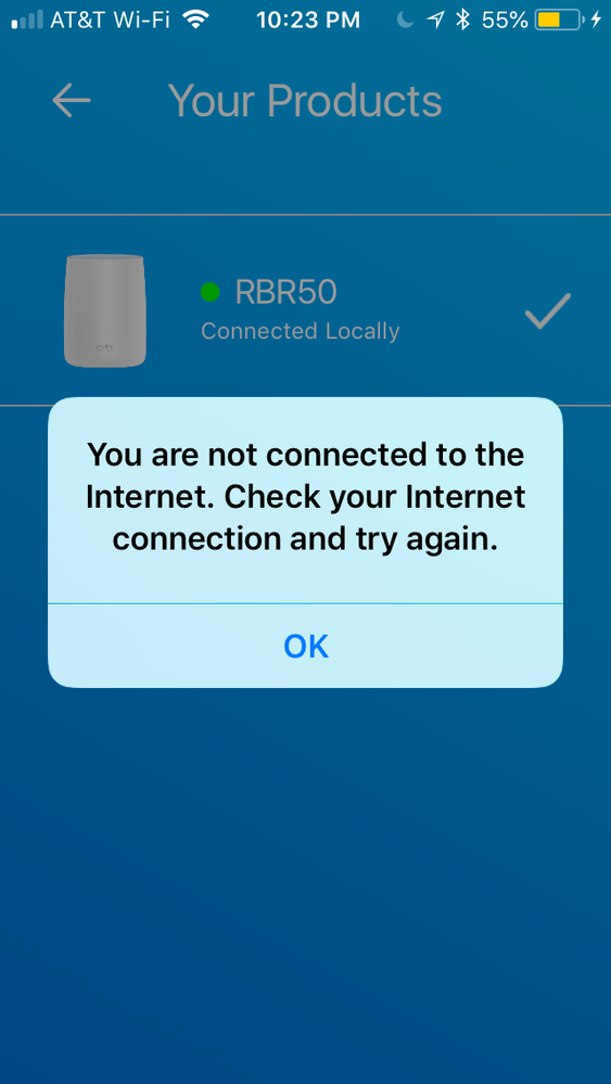

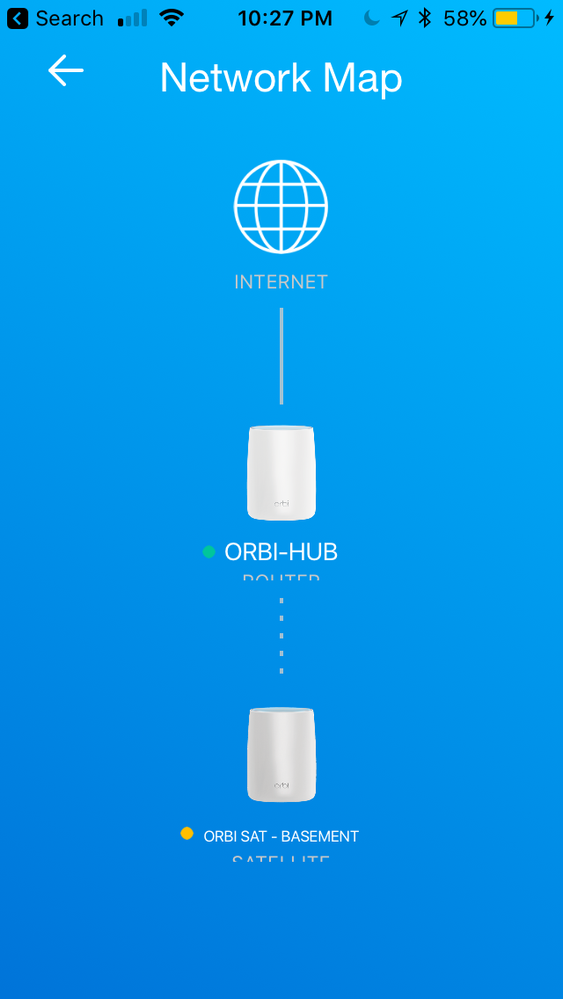

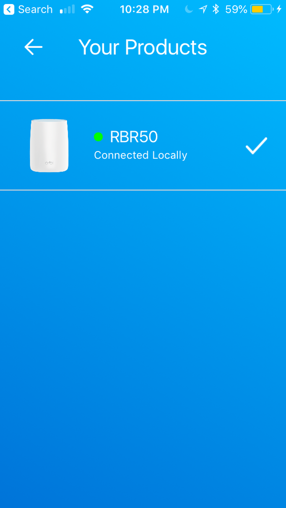

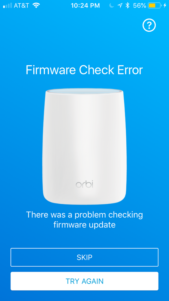

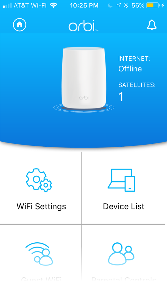

  • see picture...

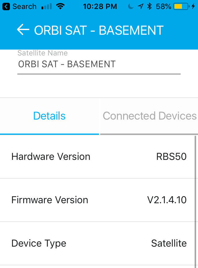

    Which Orbi system do you have?
     RBK50 – Orbi AC3000
    What FW version is currently loaded on it?
    V2.1.4.10
