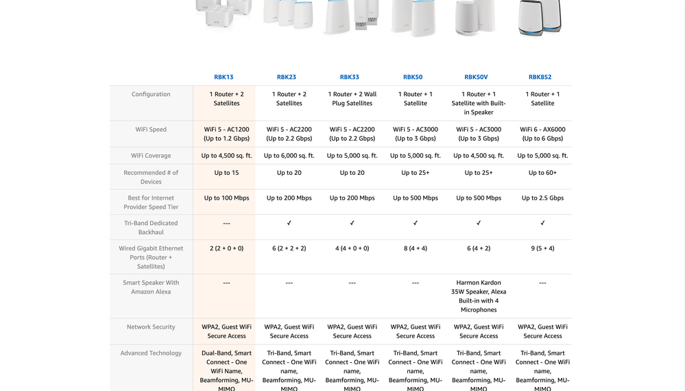

    Unless it's wired backhaul setup, it's unlikely you'll get anything close to Gigabit via Ethernet connection from Satellite.  Check Orbi/Satellite wireless backhaul linkrate , which should give an idea of what to expect.  I also have Comcast Gigabit and my wireless backhaul is steady at 1300Mbps.  My max download speed via Satellite is similar to yours on a good day ~500Mbps.  On a bad day it's half, hovering around 250Mbps-300Mbps.
    Orbi Internet Speed Tier:
