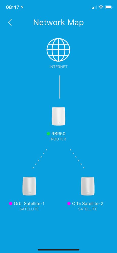

I have an RBR50 connected directly to a BT Openreach ONT and running in router mode. The internet connection is up and running and stable. There are two RBS50 satellites spread through the ground floor of my property connected via Devolo Magic 2 powerline adaptors. This setup worked perfectly with the satellites showing as "wired" in the attached devices page of the Orbi web page.
Over the past week, the satellites have been showing as not connecting properly, as in not showing as "wired", on the Orbi web page, and one satellite wasn't even being recognised as a satellite. It was showing in the list of attached devices below the satellite section. I have reset every component in the network back to factory defaults, including all the powerline adaptors, and reconnected the satellites using the Orbi setup wizard.
The current status is that the satellites are now showing correctly on the attached devices page, but with a 5G connection and not wired as they should be. The Orbi app indicates that the satellites are offline. Please see attached screenshot from the Orbi web page. I am out of ideas of what I now need to do to get the network back to full functionality.

      The satellites aren't connecting using the ethernet (powerline) backhaul, only via 5G, and this isn't even getting correctly represented in the Orbi app. According to the app, the satellites aren't connected at all. The network was working fine up to around a week ago and I can't think of any additions, electronically, that have been added to cause this. I can't even blame a firmware update as there hasn't been one for a while!

        The satellites aren't connecting using the ethernet (powerline) backhaul, only via 5G, and this isn't even getting correctly represented in the Orbi app. According to the app, the satellites aren't connected at all. ----so you disconnected the powerline? Again, if somethings causing interference on the powerline, it can be switching back and forth from powerline (which is sees as ethernet) and the 5ghz backhaul. This can cause instabliities and the app can be showing the wrong connection. The network was working fine up to around a week ago and I can't think of any additions, electronically, that have been added to cause this.----it doesn't have to be an addition. It can be something as simple as a cell phones power supply going bad that can cause interference. Or a piece of electronics. And that electronics might not go bad for a long time as some electronics don't care about a clean power going to them. but when your using powerline, you need devices that aren't causing feedback into the power system. Its tough to troubleshoot when it does happ.  I can't even blame a firmware update as there hasn't been one for a while!
