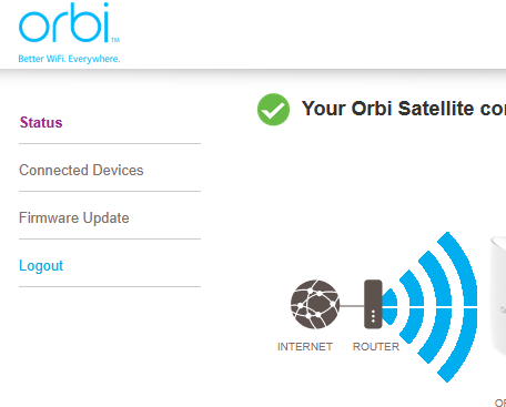

    Many Orbi WiFi5 satellites have their own web page with an option to manually update firmware.  When I open a web browser to the IP address of my RBS50 satellite this web page appears:
    Selecting Firmware Update allows me to manually upload the firmware that I have downloaded from Netgear and extracted from the zip file.
    Does the RBW30 have a similar web page?
