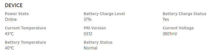

      New unit fired up and immediately requested firmware update. Now I have new LAA and AP isolation capabilities, as well as this battery nonsense. My new unit is again not charging, stuck below 40%. See attached image for stats. Device screen says "Battery Heat Mode -- Battery charging stopped due to high device temperature." It's mildly idiotic for it to be panicking over heat yet also report "battery status - normal" and "battery charge status - yes".
      I'm guessing my original unit was fine as well, but just didn't have the firmware smarts to say what it thought was wrong. Frankly, this is inane -- my unit sits on a table in my home office 95% of the time, always plugged in. How exactly is it getting so warm? Why are its tolerances so finnicky when this is as bland an environment as one could ask for?
      Unit is Gen1, firmware 12.05.05.00, build date 2018/07/25. Ethernet standby is disabled (attached to house network on a Netgear switch, for wired printer & other devices) and unit is always on, acting as the external gateway for the household. Having ethernet on is no excuse for reacting badly to warmth.

      Turning off LAN port: Are you sure you don't have "ethernet standby" set? See screenshot.
      Otherwise, sounds like maybe your unit is just aging prematurely.
      I am also a rural user of my MR1100 as the household's main connection. AT&T service in my area is quite good. I get steady rates in the range 40-70Mbps, better in the evenings and on weekends, of course. I'm insufferably annoyed that I can't reasonably take the thing mobile, but fortunately we have another hotspot (Unite) that does pretty well, too. One of the big advantages of the MR100 for us is the LAN port to keep it connected to the household wired LAN as well as providing wifi.

        The only indication is the front screen, which will say "battery heat mode" plus words that charging is suspended. In this case, the web page indicators are stupidly wrong (see screenshot), because it says "battery charge status - yes" even though it's losing charge.
