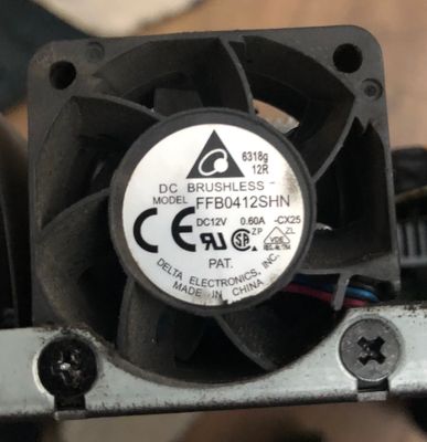

Just received my pair of Noctua NF-A4x20 FLX fans I intended on replacing the stock ones to reduce the noise of the refurbished switch I've just bought, which I waited until I received it to check the fan size and voltage before ordering these.
Just connected the Noctua in them, fired it up to check which way the fan blew, and it didn't turn at all, plugged the original back in and that works fine.  Maybe the pin config is different, so I checked the volatge polarity only to find 5V's on the pins?  How can this be?12v fan

  • Hey did you ever get anywhere with this? I have the same switch and did the same thing - opened it up, saw the 12v fans and ordered the 12v noctuas which spin up for a second or 2 then stop.
    Checked the voltage and it's putting out around 6v.
    Opened up a GSM7248 and it had one of the exact same stock fans but that switch was putting out 12v from the pins. If I try that one in the M4100 it runs no problem.
    If I try the noctuas in the GSM7248 they run and stay running and no fan fault light.
    Should I just try the 5v versions of the noctuas instead?

    1) Yes, for some daft reason Netgear don't use the normal pin configuration on their fan headers, thus necessitating dropping pins out of the fan's line socket and rearranging them, its not difficult to do but is annoying, get it wrong and you may not only damage the fan but the switch too. Most fan manufacturers use red for +ve, black for -ve and yellow for speed sensing.
    2) The voltage at the header varies for fan speed control, using the wrong fan may mean that the voltage supplied for low speed may fail to turn the fan at all and hence trigger a fan failure alarm.
