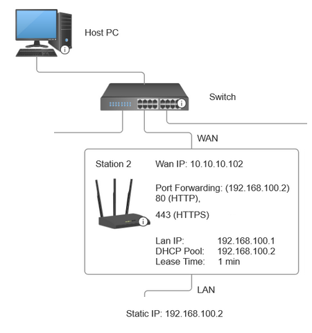

Hi, Everyone, I have a managed NetGear Switch M4350. The set up is easy, as follows. Host PC 10.10.10.9, there is only one VLAN on switch (10.10.10.1), and every port is its member. Router i...

Found out the reason, why it's not working. The SFP module on the switch doesn't support 100mb ethernet, and the router wan port only goes up to 100mb

spaceSlug wrote:I tried:
ping WAN port of the router from PC with PC directly connected to the router -> works
ping another static IP static 10.10.10.103 from switch -> works
swap the switch with an unmanaged switch and ping 10.10.10.102 from PC -> works
change the router to another model, do the same configuration -> ping doesn't work
Often routers won't respond to pings received on their WAN port by default.
Have you checked the router security settings to see if that is the case here?
- spaceSlugMay 21, 2025Tutor
Hi, Stephen, thanks for the reply, yeah, I have enabled the WAN port ping on the routers and I can actually ping it, if I have a pc directly connected to the router
