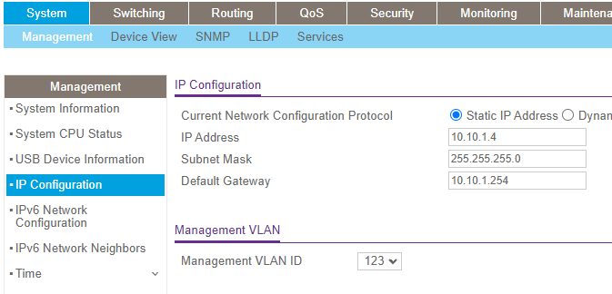

I have changed the subnet mask on the router from 255.255.255.0 to 255.255.252.0 because I need more addresses. This caused issues: the computers that were assigned one of the newly available IPs were still able to connect to the wifi router, but not to the internet.
I use an XS716T. In System > Management > IP Configuation I saw that I should probably adjust the subnet mask as well. However, trying this throws an error:
"Error! System Network Config protocol must be NONE to set IP address."
Does anyone know how to fix this?
Thank you in advance.
Is the XS716T configured to Current Network Configuration Protocol for DHCP (Dynamic) probably? You need to configure it to a static IP to override the DHCP assigned Subnet Mask. Assuming your router is serving DHCP, and the DHCP server is correctly configured, you can consider to reboot the switch.

The switch is indeed cofigured for DHCP.
The first screenshot below shows the status quo.
Do I understand cotrrectly that you suggest I set the settings as in the second screenshot?
Or are you suggesting that I could first simply try to reboot the switch and see if it sets itself correctly?

I rebooted the switch and the switch has set the correct configuration. Thank you very much. 🙂
