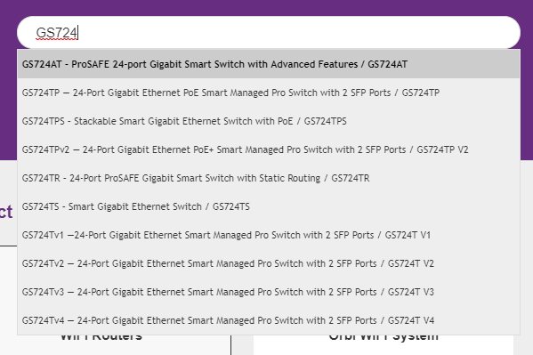

    There are many different GS724xxx and GS748xxx models. Provide exact model, version, and firmware version in place.
    While there might be differences in the feature set, in the Web UI, the networking standards functionality is certainly compatible.

      Sorry, I should have said, all ar v3.

        The latest firmware version for the GS748Tv3 is v3.1.4 while the latest firmware version for the GS724Tv3 is v5.4.2.30.
        For the GS724Tv3, I suggest you to upgrade the firmware in a ladderized manner.  First, upgrade the firmware from v4.2.1 to v4.2.1.5.  Then, from v4.2.1.5 to v4.2.1.8 and so on until you reach the latest firmware version which is v5.4.2.30.  Be sure to perform a factory reset on the the GS724Tv3 switch/es after upgrading to the latest version then reconfigure the settings from scratch in order to start clean using the latest firmware version.
        You may want to take screenshots of the settings configured on the GS724Tv3 switch/es before you proceed with upgrading the firmware.  It is because the config file you saved from firmware v4.2.1.x will not be restored once the firmware has been upgraded to v5.x.x.x.  You can download the firmware versions for the GS724Tv3 switch here.
