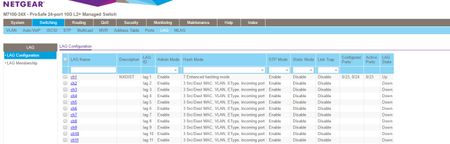

Hii, Im not used to using netgear, because i only have experience with cisco. I have netgear M7100-24X 24 port, and connected with cisco 2 Nexus 7000. I configure the netgear to nexus using ...

Thanx for the reply, i already read the pdf file you mention it, and already follow the instruction before i post in here, it still have only 1 interface UP to my cisco.
I followed the instruction on link above too, netgear with cisco, and still only 1 active, the other link standby.

Thats mean I have 20G uplink on the each netgear to nexus, 40G the total uplink? I think its same, the different is im using 1 link to each nexus, i using this method to my all cisco device and its work. If 1 link can normaly connected, i think 2 link or more should be connected to, but in my case, its only 1 link who connected.
If there any STP config or the other config i miss?
