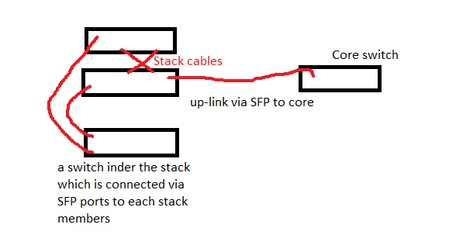

Hi, I have two stacked M5300-28G-POE+ switch which are connected to the core switch and the core switch is connected to the default gateway. We have a DHCP server. The problem is that when we hav...

Hi EricZ,
Thanks for your comment.
1. two M5300 stacking via stack modules with stacking cables.
2.Yes
3.Trunk port 1/0/49 is connected to a third switch (M5300-28G-POE). port 1/0/50 is reserved for future use and is not connected to any device. port 2/0/50 is also connected to the third switch (M5300-28G-POE) via SFP.
4. Yes, exactly.
5. Stacked switches (52) ports has firmware "10.0.0.44" and the thirs switch which is under the stack has "10.0.0.53".
BR,
Arian
