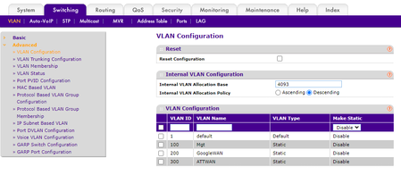

I am using a M4100-26G for a home lab. I want to be able to partition off a few ports to act like a separate switch. I will include the configuration screen shoots below. What I am running in...

ChrisLindsey wrote:
What I am running into, I can create the port groups using VLan, however, when I plug in certain cables the network switch stops responding and is hung until I un-plug the network cable.
A little bit vague. Are you trying to cross-connect different port groups with this cabling? One might guess this is intentional to avoid network loop conditions. The common mechanism in place is STP (Spanning Tree Protocol) https://en.wikipedia.org/wiki/Spanning_Tree_Protocol
Significantly faster in the loop discovery time is RSTP https://en.wikipedia.org/wiki/Spanning_Tree_Protocol. Said that, this is switch-wide.
A more advanced version is MSTP https://en.wikipedia.org/wiki/Multiple_Spanning_Tree_Protocol allowing to limit a spanning tree to a VLAN.
A good point to start in case of a problem is always the switch log where you can see the reason why the switch does stop responding.
Lot of learning ahead 8-)
