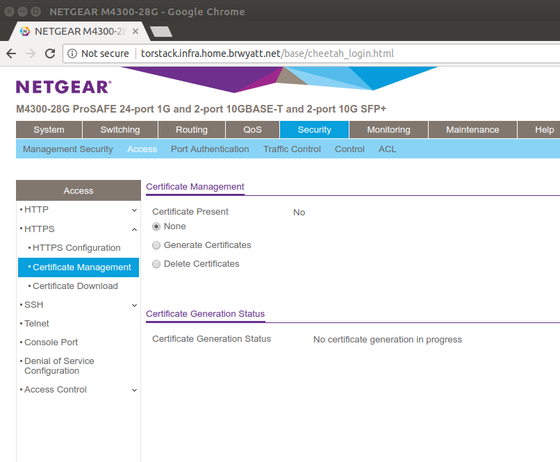

Then I double-checked the Settings to make sure that Admin Mode was Disabled before stating and that there was no Certificate currently present:
* https://s3-us-west-2.amazonaws.com/netgear29767800/InitialSettings001.png
* https://s3-us-west-2.amazonaws.com/netgear29767800/InitialSettings002.png

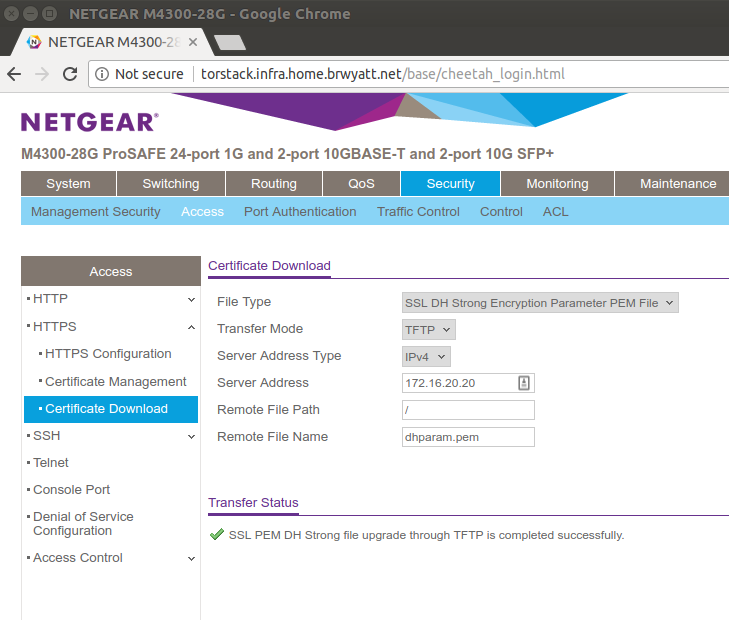

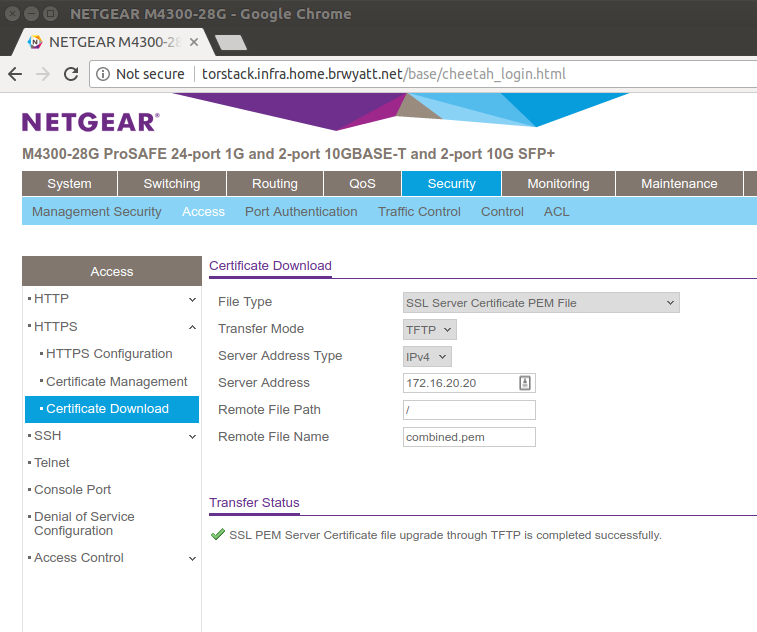

* https://s3-us-west-2.amazonaws.com/netgear29767800/TFTP_Trusted_Root_Success.png
* https://s3-us-west-2.amazonaws.com/netgear29767800/TFTP_DH_Strong_Success.png
* https://s3-us-west-2.amazonaws.com/netgear29767800/TFTP_Server_Cert_Success.png

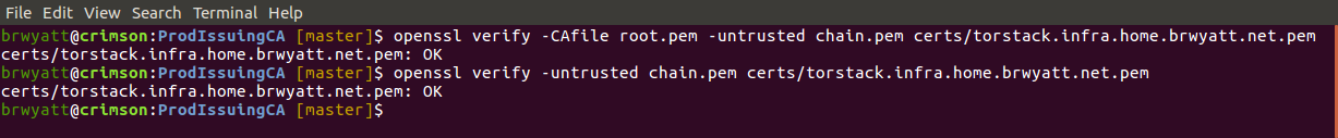

But, I can validate this certificate and chain using OpenSSL locally (both specifying the Root cert, and defaulting to using my system cert store, additionally validating I have the cert installed, though, as the above errors point out, it isn't a cert issue, this is a protocol issue, but figure I'll include this for completeness and to remove any doubt or confusion):
* https://s3-us-west-2.amazonaws.com/netgear29767800/OpenSSL_Verify.png

  • With atian's help, I have found the solution.
    In addition to "pem format" and "include the private key with the server certificate", any chain CA certficates must be appended to the server certificate file, not the trusted root file, and the Trusted root pem file should only contain the root. Doing this has resulted in the switch properly serving HTTPS and a complete chain of trust to the root CA in my computer's trust store.
    I want to be VERY clear here, though. Other than "PEM Formatted", no other guidance or information is offerred in any documentation I was able to find or anything offered by support. Nowhere does it say that the private key is to be prepended to the "Server Certificate PEM file", nor does it offer guidance on where to add or append or upload CA chain files (many systems I've used before use separate files for the server private key, the server certificate, and the CA chain certs). This REALLY needs to be documented, and would have saved me two and a half months struggling with support that doesn't have a clue about how this is supposed to work, either (I'm guessing the internal documentation doesn't mention this, either).
