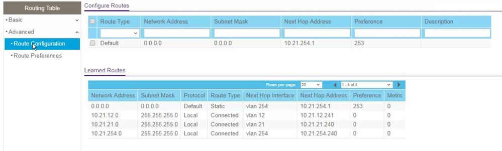

We would need to see the routing table before making any guess (would a Layer 2 setup be more suitable to your application, or should we continue tuning the static routes).
Please post a screenshot of the Weg GUI learned routes at Routing\Routage Table\Advanced\Route Configuration - thanks in advance

learned routes
- oheymannsNov 28, 2018Aspirant
10.21.12.0 is an other VLAN 12 for other PCs on an other M4300 switch with the ip 10.21.254.241. Do you need any other information?
- LaurentMaNov 28, 2018NETGEAR Expert
OK thank you very much. I believe it won't work per your requirements with current static routing. I would revert back to pure Layer 2 installation of your VLAN 12 and your VLAN 21. These two VLANs should not be "routing VLANs" anymore and all their traffic should be sent to your firewall straight. A trunk with all VLANs should go to your firewall and your firewall should act as the gateway for VLAN 12 and VLAN 21. This way, your firewall rules will function normally. schumaku do you think the same?
The switches' management VLAN 254 can remain a routing VLAN, in order to let all services function normally in the switch. I hope this helps -
