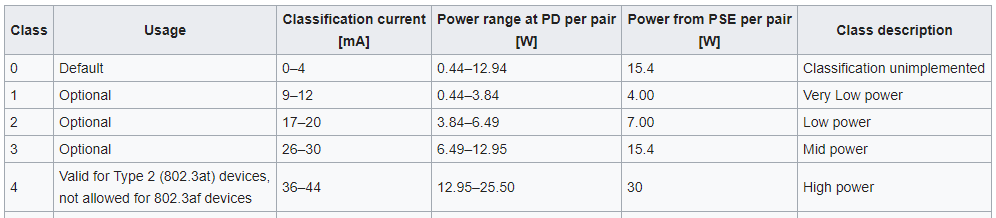

      • schumaku's avatar
        schumaku
        Fred,
        With a camera requiring "up to 16W" it can't be PoE as per the initial IEEE 802.3af-2003 standard, which can provide up to 15.4 W on each port (at the power source equipment, PSE), but only 12.95 W are guaranteed at the PoE device (powered device PD).
        Next higher standard is
        IEEE 802.3at-2009also known as PoE+ or PoE. Here we have up to 30 W vailable at the PSE, and maximum of 25.5 W at the PD.
        A camera requiring "up to 16W" must request a Class 4 power from the PoE+ switch:
        Provide more information on the camera (make, model, PoE class, ...).
