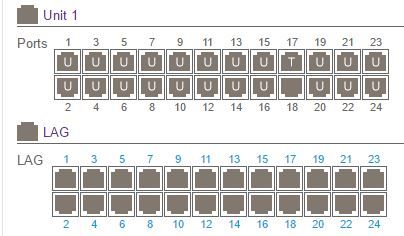

I'm currently using two of these switches for our SAN network. I'm trying to connect both switches together but no sucess at the moment. I have vlan 80 set for iSCSI and set it as T for one port I'...

1. Could you please provide a simple topology? How to connect these two M7100, via port17? And does VLAN80 configure IP address or not? How to connect two switches to iSCSI Clients and Server?
2. Port18 is for management on two switches? And does two switches management IP is reachable?
3. Is the iSCSI service ok? Does the iSCSI client can ping iSCSI server?

Since my original post. I have changed my approach to using LAG. But still doesn't work.
The subnet for data paths is 192.168.80.0/24 on Vlan80.
Port 18 on each switches is connected on a management network separately so I can access them both which on different vlan and subnet from iSCISI.
Our SAN performance is okay until now that we are trying to implement VDI. We tested the IOPs on the SAN from our VMWare server and we're not getting anywhere near the 75k IOPs that our SAN manufacture said it can deliver. By contacting support, the tech suggested me to Trunk 2 switches so that the host would see all 8 paths. By doing so, the IOPs should be much better. I also chose to use LAG instead of VLAN Trunk so I can use 2 lines for uplink instead of 1 for future growth.
