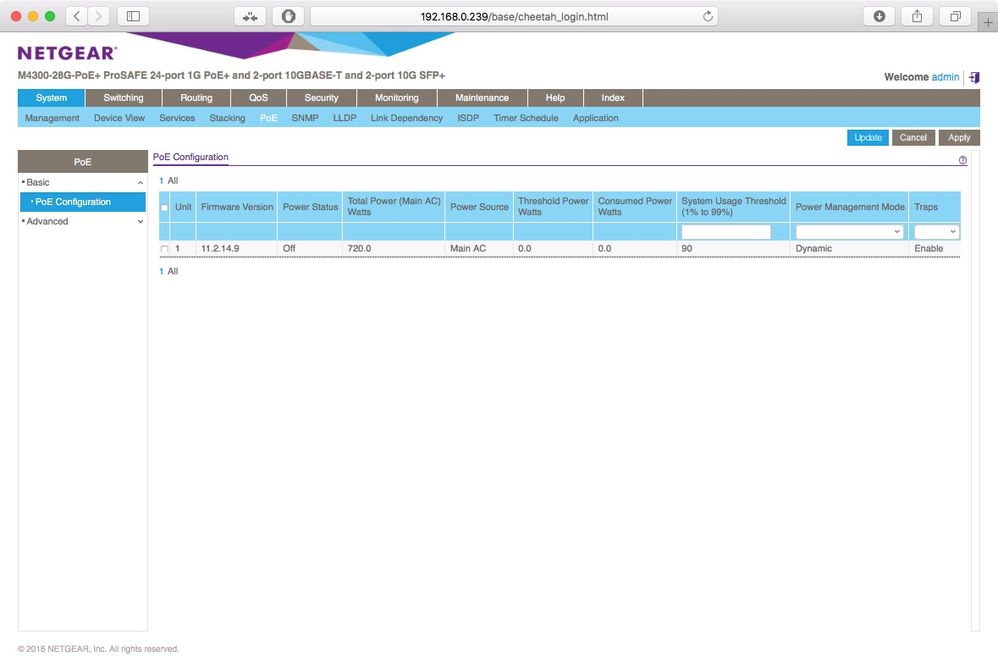

The connedted devices don't power up. Nothing happens. (The devices itself power up and work when they are connected to a different PoE switch.) I am aware about the handshake for PoE, and that it is only provided when the device needs it.
System > PoE > Basic > PoE Configuration > Power Status ON/OFF
Should this parameter automatically switch to ON when PoE demands are detected? Because it doesn't. It is always OFF. That's why I was wondering if there is a general configuration menu to enable or disable PoE systemwide.

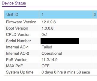

a. Software Version
Firmware 12.0.2.6, Boot Version 1.0.0.8
b. Unit 1 box

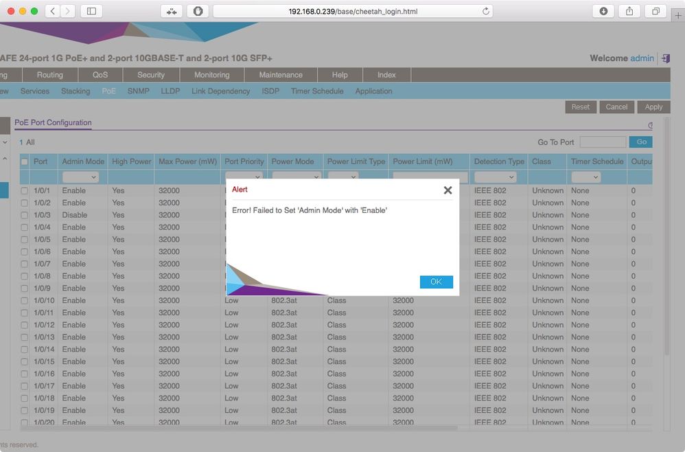

When I activate the box and click 'Apply', nothing happens. The status stays OFF. A PoE decive is connected and does not power up.
In the PoE Port Configuration, I disabled the 'Admin Mode', just to give it a try. When I tried to enable it again, there was an error message. This applies to all ports: disabling Admin Mode is possible, but when it is once disabled, I cannot enable it on any port.

Please find the screenshots attached.

- DaneAFeb 13, 2018NETGEAR Employee Retired
Thanks for the feedback.
I suggest you to update the firmware of the M4300-28G-PoE+ switch to v12.0.2.20. You can download firmware v12.0.2.20 here. Be reminded to perform a factory reset on the M4300-28G-PoE+ switch after upgrading the firmware then reconfigure the settings from scratch. Then, check if the same problem occurs.
