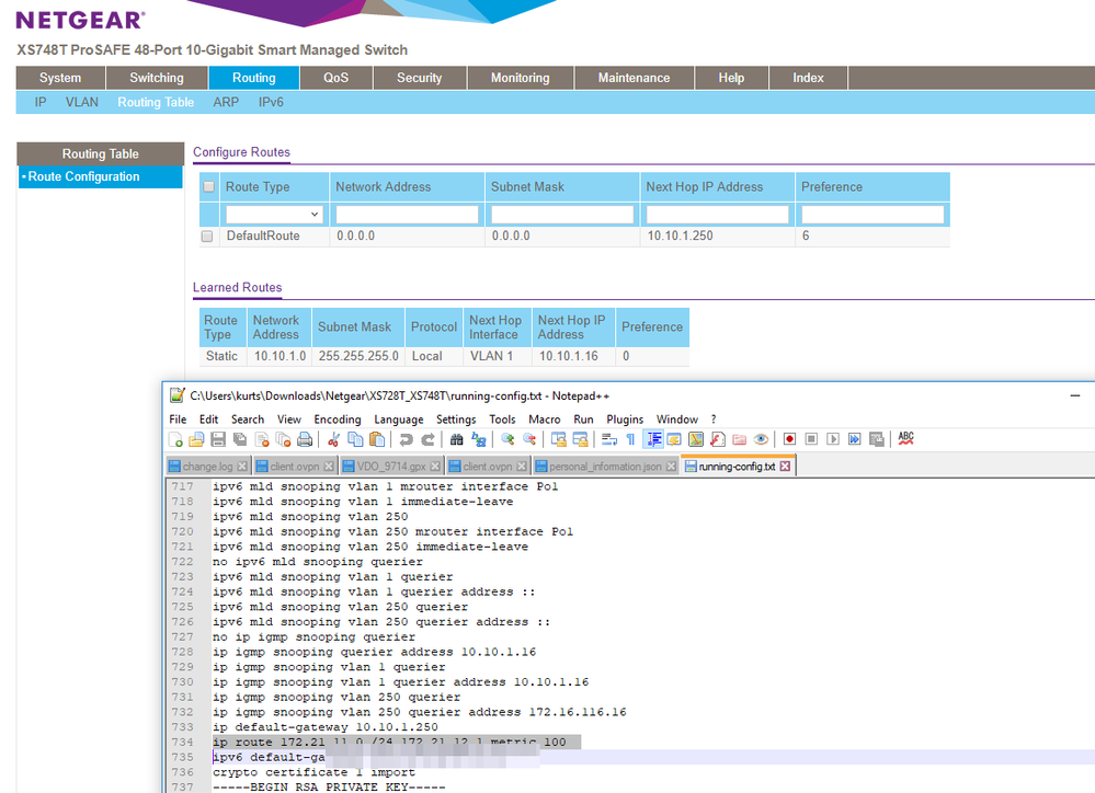

  • schumaku's avatar
    schumaku
    Breaking it down to one senence: It appears that the switch CPU/management interface on subnet C does ignore configured static routes neither allowing to use the Web UI nor allowing to use tftp from/to the A and B subnets.
    On a side note, you wrote "Our switches are on a private network C, though they are routing traffic from two public networks A and B, which is all nat'ed by an ubuntu server." The switches (at least the subject XS748T) are not routing, but plain L2 VLAN switching, isn't it?
    What I don't understand - why adding static default routes if the gateway (you have only one on your switch, because there are no other VLAN interfaces with IPs) is the same like the default gateway anyway?
    ip default-gateway C.x.x.250
    ip route A.x.x.0 /24 C.x.x.250
    ip route B.x.x.0 /24 C.x.x.250
    While quickly testing I found the XS748T on 6.5.1.31 Web UI does not show static routes configured (and active - VLAN routing here) - re-adding is refused as the route does already exist, and updaing is possible by re-adding the static route and change e.g. the gateway or the metric and [Update] LaurentMa bradleyv whoever is in charge:

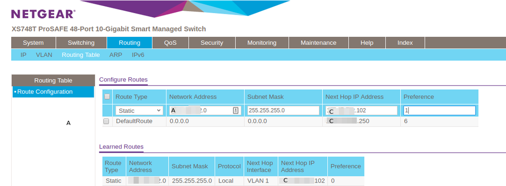

        There are two networks involved, let's call them A and C. A is our public network space and interfaces out to the internet at large. C is our private network space, where we typically put our switches, CAS, PDU, idrac, IPMI and other network infrastructure.  We have an ubuntu server running 14.04 that is our NAT to the C network.  So it's eth0:0 IP is a A.x.x.3 and its eth0:1 IP address is C.x.x.250.
        The netgear itself gets a static IP address in the C network (C.x.x.102) but it will be providing connectivity to servers that are on either A or C subnets. At present I have one of each connected to the switch (and they're doing fine, actually).
        What I am having trouble with is getting the switch to consistently connect with servers (other than the NAT) on the A network.

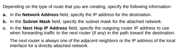

        Looking at the User Manual (yes, I have been all over this thing), http://www.downloads.netgear.com/files/GDC/XS728T/XS728T_XS748T_UM_EN.pdf to be exact, on page 173, I can see that I need to set the routing as follows:
        Network Address: A.x.x.0
        Subnet Mask: 255.255.255.0
        Next Hop IP Address: C.x.x.102
        Preference: 1
        (ie the next hop is the IP address of the switch). But the error message is "Gateway cannot be one of the addresses configured on this device."
        I do have routing enabled (that's the default) under Routing/IP/IP configuration.
        Here's the relevant portion of the manual I'm looking at:
        Thoughts? The connection works intermittently (as if various arp tables are briefly in alignment until something times out, but I can't consistently get them to talk.  Then when I did get a connection (see below), I went over to do a traceroute on the switch right
        after the traceroute from the A server below. Then immediately the connection was lost. You can see the timestamps before and after on the 'date' commands...it's within a minute :-/  I can consistently ping the NAT and I can consistently ping C subnet servers on any of our switches and I can consistently ping A servers that are connected to THIS switch.  So it's a routing problem. But I can't add the route I want!  I've tried various other things, like listing the A network IP address of the NAT server (that error message response says "Only a directly connected router can be defined as the gateway" -- and that's NAT's C.x.x.250 address).
