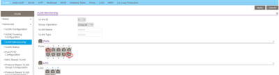

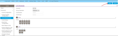

      Tried this using Chrome for the first time, to make sure it doesn't have any cached data. The behavior is the same. Attached some screen shot below :
      Before Apply:
      After Apply:
      This perfectly working before the FW update, unfortunately, don't remember the FW version number before. With this current Firmware it does nothing.
