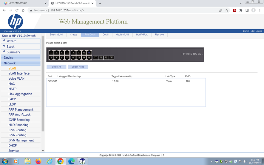

Ok Here you go ---- the Netgear:
And the Procurve:
Note that Port 8 on the Netgear is cabled to Port 15 of the Procurve.
Also note that I have tried establishing PVID 100 on the Netgear as it is in the Procurve. The picture provided shows PVID 1 on the Netgear but as I said I have attempted this using PVID 100 with no success.
Hope that helps.
-JB
