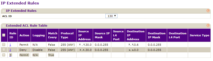

I was wondering if somebody could help me with an ACL configuration issue.
We have recently implemented a separate VLAN (VLAN30) for our guest Wi-Fi.  The wireless access point is connected to port number 22 on a GS728TPP Smart Switch.  The smart switch is then connected to an M4100-12GF (Backbone2).  This then runs across the building to another M4100-12GF (Backbone1), which then connects to our firewall.
DHCP for VLAN30 is controlled by the second M4100-12GF (Backbone1). VLAN1 is on x.x.0.0 and VLAN30 is on x.x.30.0.  Default route is x.x.0.6.  I can connect to the wireless access point without issue, get the relavant DHCP details and surf the internet without any problems.
The issue I have is when I try to block access the rest of the x.x.0.0 subnet.  I have setup the ACL on the GS728TPP as follows, and then bound it to Port 22:
From everything I have read on various Netgear threads over the last 2 days this should be ok.  However if I connect using a laptop I still can access or at the very least see (ping) devices on the x.x.0.0 subnet.
Any help you can give would be appreciated.
Cheers
Jim

    According to your description, suggest you try to binding following ACL configuration to GS728TPP port22.
    1.Deny:source x.x.30.0 (0.0.0.255) and des x.x.0.0(0.0.0.255)
    2.Permit all
    If have any other questions,please let us know.

  • Dan_Z's avatar
    Dan_Z
    NETGEAR Expert
    Welcome to the community!
    2.Permit all
    Thanks.
    • namajim's avatar
      namajim
      Hi Dan_Z
      Thank you for the response.  Have I not already got both of those rules in there already unnder 2 and 3?
      Cheers
      Jim
      • Dan_Z's avatar
        Dan_Z
        NETGEAR Expert
        Hi Jim,
        The ACL rule match according to the sequence (Rule ID),so suggest add deny policy firstly.
        If the traffic matched the first rule,the following rules will not take effect.
        Thanks.
