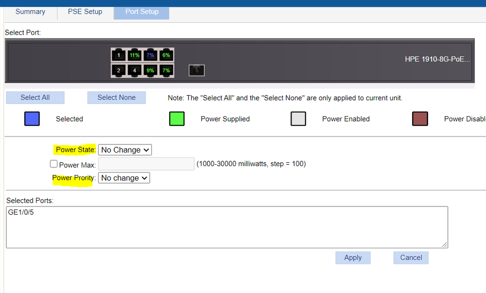

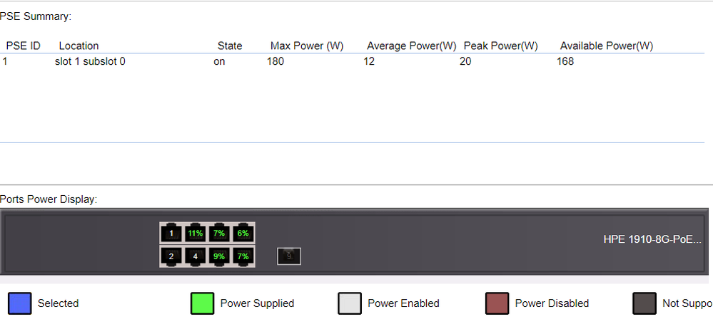

        The HP switch is underutilized and all 3 Ubiquiti UAP-AC-Pro have been connected to it for years. Only a 3rd GS105PE was added recently. So right now, the setup is HP switch - 3x GS105PE - 3xUbiquiti UAP-AC-Pro . There is also an IP phone and a Ubiquiti cloud key. So not much power draw.
        I suppose I could change the power priority to 'critical', but I am not sure that would change anything. Let me know if you think i should do that. (FYI power save is disabled on the port)

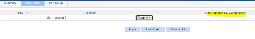

        I just saw a feature that might help. Should I enable it?

        > HPE 1910-8G-PoE+ (180W) Switch (JG350A) ... so this side should be fine and able to work, it's definitivley a PoE+ device and with the 180W version it has ample of power available for the GC105PE and the UAP-AC-Pro.
        The proof that it can power the three UAP-AC-pro does not proof much - except that it can supply the 802.3af power on the ports I'm afraid.

        [edit] There is no the non-standard PD detection function for a PSE or for all ports enabled? [/edit]
