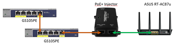

Hi,
I need (or rather want :smileyvery-happy:) to install two switches in a place where there is no power.
My existing network consists of an ASUS WiFi Router and not much else.
My plan is as follows:
  • Run power + data via a PoE+ Injector to the first GS105PE
  • Run the second GS105PE off of PoE Passthrough from the first GS105PE
  • Only run data (no power) from the rest of the available ports (PoE only needed to power the switches themselves).
I hope this mockup will explain my theory:
Will this work?
Thanks in advance.

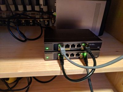

  •  Thanks for your replies.
    Both devices have shipped today and I have just set up a simple test.
    Before I go into further details: my plan works! :smileyhappy:
    Regarding your statements:
    • a: I do of course understand the limitations in bandwith / speed.
      • I gladly take this drawback for the added convenience
      • Originally, I simply wanted to run one cable from point A to B - these switches are meant to be for future additions / serviceability
    • b: At the moment: 1 PC.
    • c: No - the added devices won't need PoE.
    Here is a quick photo of my tests (I got full Gigabit speed on either of the switches):

  • schumaku's avatar
    schumaku
    Router <-GbE-> PoE+ injector <-GbE/PoE Plus 25.5W-> GS105PE <-PoE Class0/3 15.5W-> GS105PE
    Never tried - shoud be workable in my opinion. No spare GS105PE at hand for a test I'm afraid.
    • DaneA's avatar
      DaneA
      NETGEAR Employee Retired
      Hi Mr_Stocki,
      Welcome to the community! :)
      Kindly answer the questions below:
      a. Why connect a 2nd GS105PE switch? (The 2nd GS105PE switch will only give the same port allowance as the 1st  GS105PE switch anyway, 4 Ethernet ports with port 1 & 2 PSE ports)
      b. What type of devices will be connected to the second switch?
      c. Do they require to be powered by PoE?  If yes, how much power do they need?
      For me, I would rather use the GS110TP smart switch instead of having 2 GS105PE switch cascaded.  To know more about the GS110TP switch, check its data sheet here
      Regards,
      DaneA
      NETGEAR Community Team
      • Mr_Stocki's avatar
        Mr_Stocki
