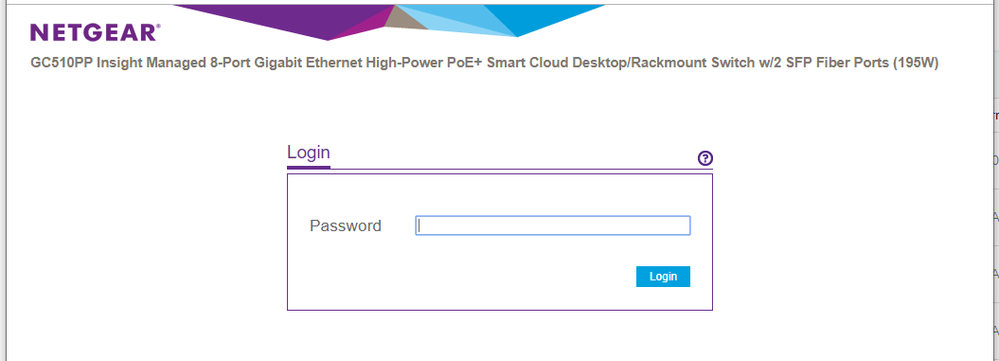

joejoe5 wrote:
...and can't login locally anymore. If I use my netgear account, i can see the device is still set to local but there doesn't seem to be a way to login.
No simple password prompt like this?
If not, they will make a lot of customers unhappy.... IphieChen YeZ Christian_R !
