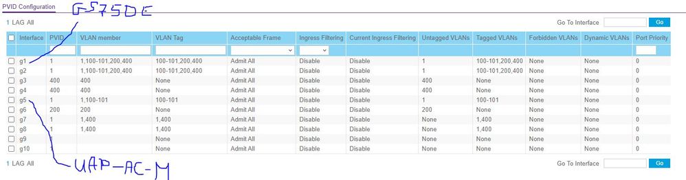

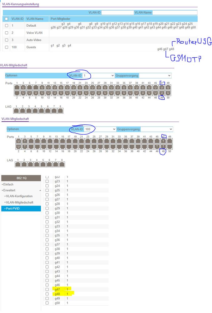

When I connect to the MAIN SSID, the Client doesn't get an IP from DHCP (stuck while obtaining IP). Also when I set static IP to the Client, I don't have any Network access! This is my issue.
But when I connect via SECOND SSID, I will get an IP from DHCP and can connect to the network without any issues.
I have checked a hundred times that the Ports are well configured (VLAN 1 is untagged, VLAN 100 is tagged from end-to-end).
When I wireshark the Port where the UAP-AC-M is connected, I see that the broadcast for DHCP request is coming from the device - but will never get an response.
When I wireshark the Port which is connected to the GS750E, I see that there will never receive the DHCP-broadcasts!
But I see also, that this communication when connecting to the SECOND, tagged SSID will go through both interfaces!
Because also with static IP I will have no network access via MAIN SSID, also other untagged traffic is not managed by the switch.
I don't know why packets are getting "lost" within the switch. I disabled all advanced features like DHCP snooping etc. So it should be a stupid switch with VLAN.
Do you have any idea. I am working on this issue since days and come to an dead-end.
Just to be sure - I have tested several UAP-AC-M and the issue looks like the same on every device! When I connect the UAP-AC-M directly to the GS750E (with PoE injector because of missing PoE in this switch) everything works well without any issues!
Thanks for your help. Hopefully we will get a solution because if this is a really incompatibility I don't know how to get official support.

      schumaku :
      Attached the screenshot from Switches with hints on which port the devices are connected . I checked it a hundred times, but maybe I misunderstood something.
      Thanks for your help!
      VLAN-GS110TPVLAN-GS750E
