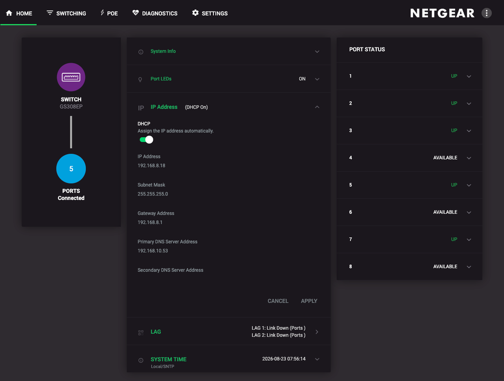

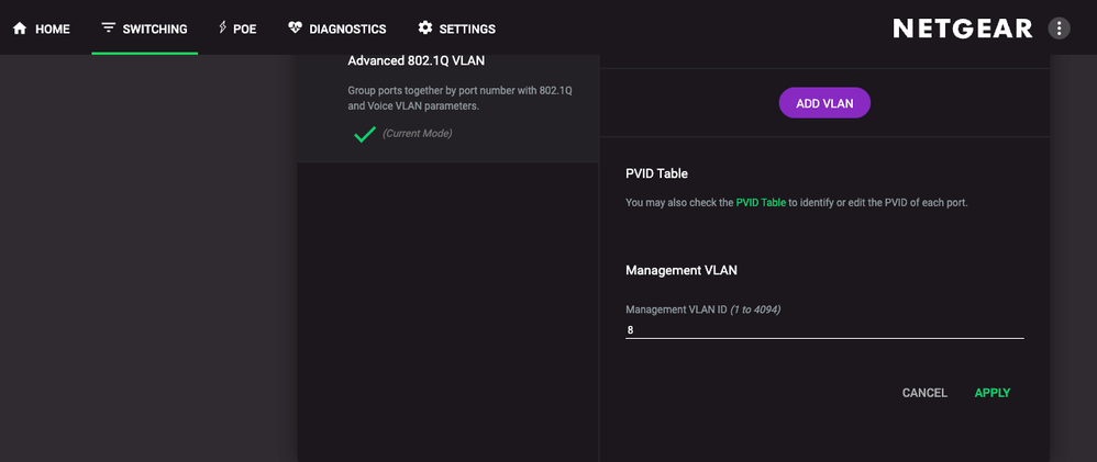

Those frames were not sent from a management PC on VLAN 8. They were generated by the GS308EP itself.
GS308EP has MAC address 28:94:01:XX:XX:XX and IP address 192.168.8.18. (28:94:01 is an OUI assigned to NETGEAR.)
The first ARP capture above shows that GS308EP sends broadcast who-has requests to find its default gateway, 192.168.8.1, using 192.168.8.18 as the sender address on all configured VLANs. Then, as expected, 192.168.8.1 (b4:96:91:XX:XX:XX) responds only on VLAN 8.
So what I am observing is that the switch itself sends ARP requests sourced from its IP management address on VLANs other than its configured management VLAN.
My report is about traffic generated by the switch itself. I have also confirmed that a broadcast ARP request sent by a host on VLAN 24 is not leaked to VLAN 9, 16, or 32.

GS308EP System Info showing the switch IP address (192.168.8.18) and default gateway (192.168.8.1).[Edited by moderator for better readability]
GS308EP VLAN configuration showing Management VLAN ID 8.GS308EP System Info showing the switch IP address (192.168.8.18) and default gateway (192.168.8.1).
